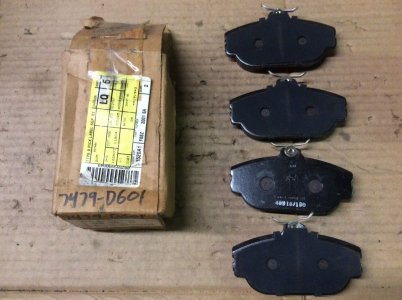

1994 Service Manual:
SPECIFICATIONS: Brake Lining and Rotor Dimensions
Lining Material (OE): AK-NS171-HFF
Lining Material (service): JB-FA002-FF
Part No ***.xx 2018 - Shoe and Lining Assy
or 1993: Lining Material: B x D7800E ABEX 91646-Q B Non-SHO, Police

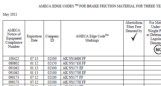

The exact answer of lining material above is useless to you. It is edge code from the lining manufacturer that the brake pad OEM gets their materials from.
You want to know more about friction material AK NS171H FF? It's made by Akebono Brake Industry Co, Ltd.
GGWIYY1
The JB FA FF brake material is Japan Brake Industrial Co, Ltd.

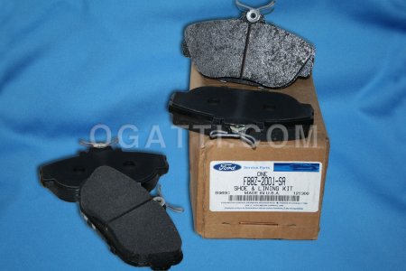

Ford put whatever the supplier had cheap in the car. Here you can see the same part # made in 2000 is different than made in 2003:
QupqmgW
110303: Abex 60x1 (x=unreadable) EE LS pads (edge code EE identify the cold and hot coefficient of friction)
HheJKAj
