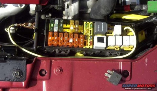

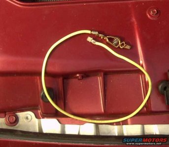

Make a jumper wire, pull out the starter relay and try to turn it over by hot wiring the starter through the fuse box. If it turns over then all is OK. If it doesn't your wires are screwed up.
Generally if you see smoke the insulation on the wires is burnt up. There are only three wires. One large hot wire from the battery, one large ground from the battery and one small one from the starter relay.
Hot wire the starter
Starter hot wire

Try The Jumper
Go ahead and try the jumper that Paul SHOwed in his post above. If the starter works properly, then you know the "high" current part of the circuit works. Then you could look at the starter relay back to the "control" circuit.

i tried the jumper that he showed above, the starter worked... I bought a brand new starter relay, and checked all the ignition fuses, they all check out good... just not working when I turn the key... i just get a click still... not understanding :(
