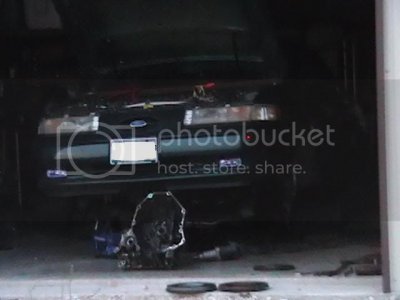

Here's a pic for some reference...
80904863
not the best pic, but you get the idea... hope that helps.
