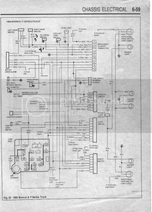

Well I just checked a diagram of my truck, which is strangly similar to the sho in many respects, and it looks like it runs from the boo switch, to the hazard, then the MFS. If you have brake lights, and when popping the hazard switch your turn signals dont work, makes me think those 2 are fine. It's almost gotta be the MFS. ?
