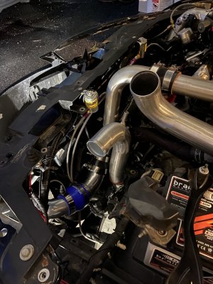

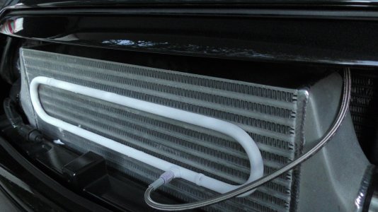

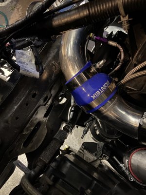

I tried an intercooler chiller bar with NO2, sprayed about 90% of a freshly filled 5 gallon nitrous bottle in about 10 seconds lol! That was enough for me to remove it and install a nitrous nozzle just before the IC inlet. Rather than spray on it, it’s more effective to spray in it. IMG 20200724 131023 229S1170021S1170020S1170007
In hindsight, I had the nitrous line hooked directly up to the bar with no nozzle, just an open line…..surely that was why it emptied the bottle. Lol. But it worked out great to use the line with a nozzle pre IC, I tried a 15 shot and 25 shot there. IMG 2294IMG 2289

I tried an intercooler chiller bar with NO2, sprayed about 90% of a freshly filled 5 gallon nitrous bottle in about 10 seconds lol! That was enough for me to remove it and install a nitrous nozzle just before the IC inlet. Rather than spray on it, it’s more effective to spray in it. View attachment 87671View attachment 87672View attachment 87673View attachment 87675
In hindsight, I had the nitrous line hooked directly up to the bar with no nozzle, just an open line…..surely that was why it emptied the bottle. Lol. But it worked out great to use the line with a nozzle pre IC, I tried a 15 shot and 25 shot there. View attachment 87676View attachment 87677
That Cryo Ring looks awfully familiar.
