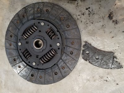

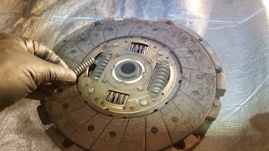

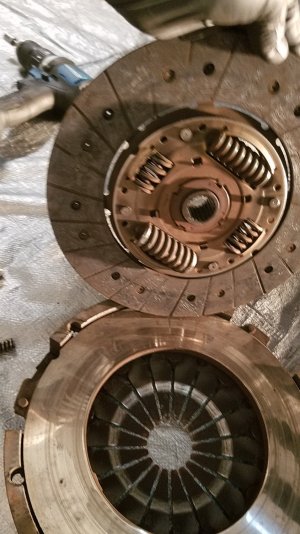

If your initial story indicates that your car moved forward and you smelled clutch material burning, then this is most likely a throwout bearing failure, possibly in combination with a pressure plate or clutch disk failure. Do a test with the engine at idle and the transmission in neutral. Press the clutch, waiting several seconds for the main shaft to spin down and try to access reverse gear. If all you hear is a steady speed grinding on each gentle attempt it means that the clutch disk is not completely releasing from the flywheel.
The throwout bearing is usually the weakest link in the SHO clutch. However, I have also had a clutch disk fail when the friction material slung off the disk during a high RPM shift. Two clutch failures have resulted in me replacing the SHO's twice in the last few years. This is a job I do not want to have to do again. The 1st failure was due to a shop not remounting the flywheel guide pins after lathing the flywheel (last time Iet a shop replace my clutch). The pressure plate was not concentrically mounted on the flywheel, resulting in vibration during clutch release and eventually dislodging one if the pair of disk shock absorbing springs (see pics). The 2nd failure was due to the friction material separating (see pic) on a Sachs branded clutch at a 7,000 rpm 1-2 shift after less then a few thousand miles of wear (yes, my well-seasoned 458K-mile SHO sees frisky driving regularly). Stick with OEM Valeo or other known good suppliers.
