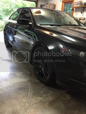

Niche, targa,m130 19x8.5. There more of a matte black with machined tinted face. Subtle contrast to all blacked out wheel. Looks even better in person than in pics.
