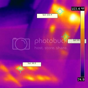

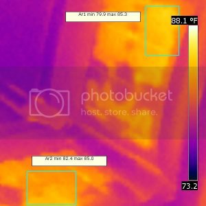

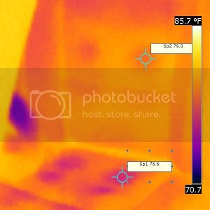

To confirm that, at least on my car, the back also is cooled and heated, I got out the thermal imaging camera tonight. Sure enough, the seat back is heated and cooled, although it is less effective than the seat bottom heating and cooling. I also checked the rear heated seats. They work, and appear to work more effectively than the fronts. They also appear to be the standard resistance wire heating elements whereas the front seats are the thermal electric coolers.
Attached are the images I took of my driver's side seats. I didn't check the passenger side front seat.
Seat and car turned off:
Caroff
Cooling feature on for 1 minute:
Dr Front on 2
Front heater on:
Dr Frt heat 2
