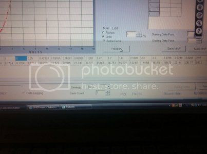

Bad news. Running Josh's X2J stratagy and idle's rough and at Idle its 11:1 AFR. So... Where d I start?
probably maf transfer. what numbers are in there now?

Nope, 847 is 55mm numbers.
Start by making sure you have no mechanical issues. How does the car run without the tweecer? It should run identically with the tweecer and stock tune.
As a starting point, increase the displacement to reflect reality, raise the idle to account for the cams, and then start making small adjustments. It is a process, and it does not happen overnight.

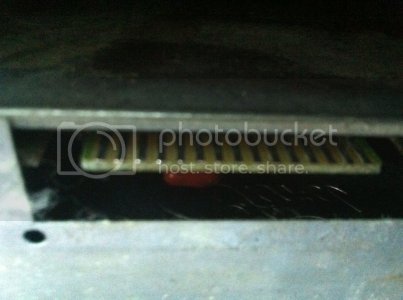

Make 110% sure that service port is spotless clean.
Check there there isn't crap in the tweecer's port also.
