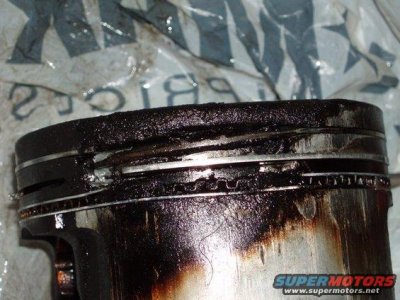

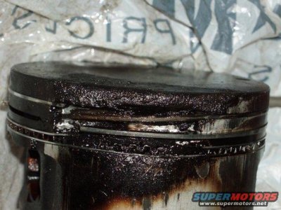

Okay, it is obviously leaned out but it only happened on #5, which oddly enough is the same one that I toasted before. All the other pistons look great.

Started blowing oil back in November of 05. I disconnected the coil in January 06 and pulled the heads last week.

Where is #5 on the fuel rail??? For the V6, #4, then #5 are the first to go lean.
