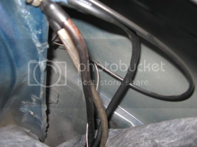

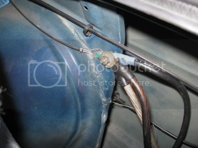

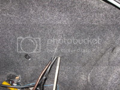

My trunk is everything the meaning of timecapsel is. Actually the whole damn car. I will post a gas receipt from 04. Think it was $1.35/gal. :biggrin: but here is what I had for a ground back then.. btw it is recommended to have a short ground. IIRC 18" or less..
IMG 2192
IMG 2193
IMG 2194

/\ those JUST taken. 2 farads of caps and a huge ass amp. Can't remember what it is at this point, it is in there, feeding JL audio door speakers, Kenwood deck speakers, and 2 Memphis 12's. It was good enough to help pull the head KU cheerleader bout 6 yrs ago :biggrin:
