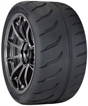

1) Toyo Proxes R888R
Load Rating: 104 (1984lbs)
Speed Rating: Y (186mph)
Diameter: 28.4"
Width: 12.3"
Weight: 35lbs
Tread/Traction/Temp Rating: 100/AA/A
R888r right

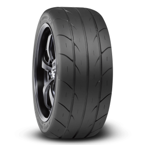

2) Mickey Thompson ET Street S/S
Diameter: 28.7"
Width: 12.0"
Weight: 36lbs
Tread/Traction/Temp Rating: 00/C/C
Mt street ss 3q lf 300dpi shadow clipped

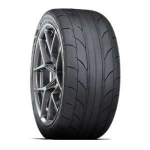

3) Nitto NT555RII
Load Rating: 107 (2149lbs)
Speed Rating: W (168mph)
Diameter: 28.4"
Width: 12.3"
Weight: 34lbs
Tread/Traction/Temp Rating: 100/A/A
NT555RII
So, the Toyos are high on my list mainly because they look bad-ass, lol. They've got the best traction rating of the bunch, but they are also the smallest as well as the widest. I'm currently flirting with rubbing (but not yet) with my 295/45s at a width of 11.7"
The MTs are a bit better in the size department, being a bit narrower and a bit taller. But they are also the heaviest and have the worst traction rating
And finally the Nitto (I'd love NT05Rs but they don't come in 305 width) are the lightest and have a decent traction rating. But I mainly don't like the tread pattern, LOL...

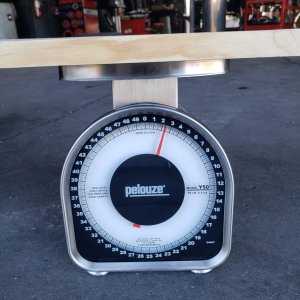

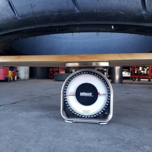

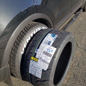

uh oh, what's going on here?!
08zdKW07lFn3twidth1024height1024cropmodenone
Even lighter than I had anticipated...
Subtract this:
RXnXpEszGQ9oQwidth1024height1024cropmodenone
From this:
T9vRALSFm oVQwidth1024height1024cropmodenone
And ya get to right about 34lbs....very nice! Compared to the Hankooks, which came in at 38.5lbs. And considering the wheels weigh in at 21.5lbs....not too shabby. Going from 60lbs (minus air and wheel weights) down to 55.5lbs per wheel. Not bad considerng the stock wheel/tire combo came in at about 75lbs a wheel!
