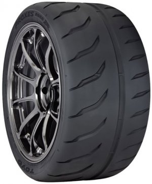

1) Toyo Proxes R888R
Load Rating: 104 (1984lbs)
Speed Rating: Y (186mph)
Diameter: 28.4"
Width: 12.3"
Weight: 35lbs
Tread/Traction/Temp Rating: 100/AA/A
R888r right

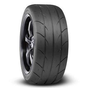

2) Mickey Thompson ET Street S/S
Diameter: 28.7"
Width: 12.0"
Weight: 36lbs
Tread/Traction/Temp Rating: 00/C/C

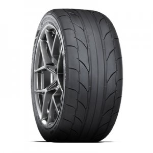

3) Nitto NT555RII
Load Rating: 107 (2149lbs)
Speed Rating: W (168mph)
Diameter: 28.4"
Width: 12.3"
Weight: 34lbs
Tread/Traction/Temp Rating: 100/A/A

So, the Toyos are high on my list mainly because they look bad-ass, lol. They've got the best traction rating of the bunch, but they are also the smallest as well as the widest. I'm currently flirting with rubbing (but not yet) with my 295/45s at a width of 11.7"
The MTs are a bit better in the size department, being a bit narrower and a bit taller. But they are also the heaviest and have the worst traction rating
And finally the Nitto (I'd love NT05Rs but they don't come in 305 width) are the lightest and have a decent traction rating. But I mainly don't like the tread pattern, LOL...

I don't have any personal experience with any of those, but I would rule out the Mickey Thompson ones just because of the 00/C/C rating.

The Toyos are used by track (road course) guys who love them. They are true track rubber with tread. Dunno about from a dragstrip standpoint, with a lot of heat.
I have never heard a bad thing about the Mickey's. Guys love them, and reports are great for a true street/strip DR.
I had a set of the Nitto 555R in 305/35/20 on 20x11 wheels on my Scat Pack last year. Frankly, they were almost too much tire!
If you want great straight line, street and strip performance, I would say the Mickey's or the Nittos. Road course? Toyos.

Yeah, I've read that the Toyos are not technically drag radials and designed mainly for the road course (which I'll never see with my rig). That's one of the marks in the "CONS" column for them for sure...I'd be interested to see if anyone has ever used them for drag racing, and how it held up...

One more thing. 555Rs already come with a minimal tread depth, so heavy rain is always dicey. At about 5k miles, I had a white knuckle drive across the Ohio Turnpike. They weren't quite at the wear bars, but the back end was dancing at anything over 40 mph!
Now, there was plenty left for someone who just did nice weather and/or dragstrip days (I did sell them). But, for DD use in Michigan in the wet, they were done.
