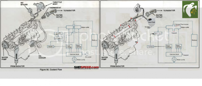

Charnal House Racingis still racing this thing. The SHO continues to be an excellent powerplant for our little MetSHO. The 3.0L did 5 races, developed a little smoke at startup, and was swapped for a 3.2L. Since adding a trans cooler and redline D4 the MTX's are staying healthy.
We just updated the cooling system to completely block off the warm-up loop. This gets rid of most the hoses under the throttle body and makes bleeding the system easier.

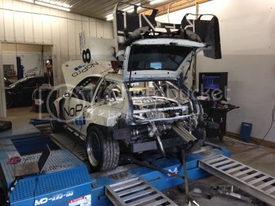

2DEED0E3 7915 49C0 8FDE EEA7796A8434 zpsyhfq2tty
Went to the dyno with Adam from pops racings x2j strategy. My tuner used a quarterhorse and we quickly got it up and running great at low load with the evo 550cc injectors and the ford slot maf.
These turbos seem very responsive, even light load we were getting 0-1psi at 3000rpm.
Getting into boost threshold we had some issues. With some heat and boost pressure the fuel injector-to-head grommet/seals started leaking pretty badly. We couldnt find replacements locally so went home for the day.
Now all back together with shosource injector seals and pressure tested to 20psi. We are going back this Sunday, wish us luck.
