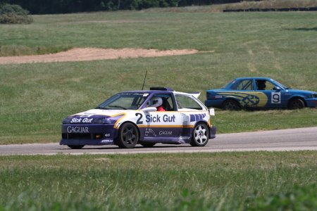

Nice job guys! 49th out of 87 ain't too bad for it's maiden race. I saw you spent a considerable amount of time in the pits, but when you were out on track, you were flying!! Like Jay said, if you guys work the kinks out, it could def be up for a LeMons win. Speaking of Jay, his face when he first saw the motor was priceless:

Yeah, I suppose it's not bad after 4 hours of penalties on sunday for constantly swapping ends. We were up to 17th position at one point on Saturday which made it a rollercoaster ride of surprises for sure.

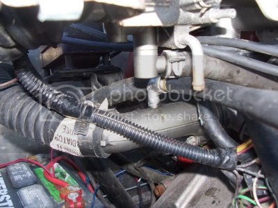

I had a hard time with coolant flow / temps in my shogun project too. Turned out that since the engine was higher then the radiator and cap (up front) any air tended to be trapped in the engine instead of up front in the top of the radiator.
I drill a small hole in the radiator neck past the thermostat , install a fitting and mounted an extra expansion tank in the back making it the highest point in the coolant system, Now I can burp all the air out the system. I also use a higher pressure radiator cap up front in the radiator and one that is 2 pound lighter in the expansion tank, so it would lift first.

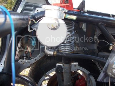

I plan on grabbing an expansion tank and a dummy cap next time I hit the junkyard. Then I'll probably tee it into the little bypass hose above the water neck.
I tried that but when the engine was cold and the thermostat closed the pressure would build in the block from the water pump. This would cause the second thermostat in the rear surge tank to lift, from pressure not heat. Once I moved the hose to down stream of the thermostat it worked fine.

We ended up going with a tank from an Econoline. Teed into the little bypass hose. Since the spring is removed from our thermostat and wired open, I don't think we will have any pressure building problems. If so, we can try the 18psi cap from a GM 3300-powered car that we also bought.
