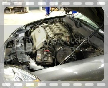

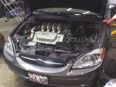

Just for conversation, Kwerk is not the only one that's done it.
We put a complete 97 powertrain, ABS and brake system into a 2003 Taurus SES.

Yup, it's outta here. Been gone for a while. The owner lives in Tacoma, WA. Took him 2 days to drive home and it got 26mpg average. That's better than what it got with the 3.0L Vulcan, by a bunch.
We took everything we could off the donor car and made it work on the '03, including rear brakes and exhaust system. We put 13" Cobra brakes on the front. We got the speedo working properly and even the tach. Took a while, but turned out really nice. I'd do it again in heartbeat, if someone had the cash.
