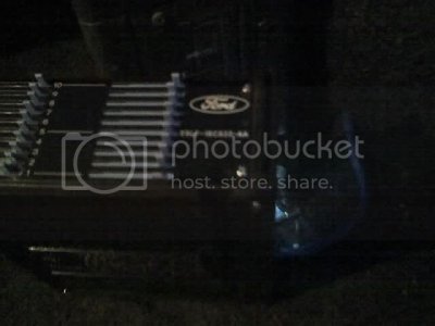

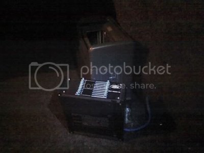

that is the same one I have ^^^^ I understand that it's a fm modulator, but the problem is that when I try to tune in with my new deck (Alpine CDA 9805), I get no signal... at any frequency (I tried every single one!) I thought it was very odd. the changer powers up just like it used to, commander works, switches discs and shows up to be playing just like normal but no sound. with the factory deck it seemed to tune into EVERY station when it was powered up and playing, witch also seemed odd. this is a ford 10 disc 100%, not sure if it was a option for a 1992 mtx or not but it shouldn't matter since it's a FM modulator.... any ideas?
EDIT: I should also mention that this is the same changer in the pic above, my deck did not control it and I don't recall any unidentified wires in the rear during installation. (is there an in line antenna for the modulator?)
