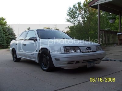

I saw this image in a lowered SHO thread and I really like the black housings. Does anyone know how to do this? I know on VWs people cook the housings, pull the lens and paint all the non reflective surfaces. Is this the same procedure? I PM'd the poster but doesnt look like hes been on in a long time.

Are the lenses in the car pictured tinted, or is the housing painted?
You might be thrown off by the amber being painted.

I'm pretty sure they're black housings, I've owned a lot of mustangs and *** products as well as built a few civics for friends so I'm familiar with the look. Notice the lens is clear but the non reflective area is black. Black housings are a fairly common "modernizing" upgrade and I think it would look good on my Gen 1. I just wonder how big the interest would be in Gen 1 clear lenses. I like the way HIDs and projectors spread light but not sure if its worth the hassle.
