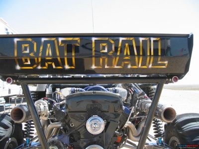

Or...I would just do this and be done with it.
Batrailrearview
Tom
