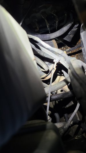

In this picture there's this vacuum diaphragm thing and I can't figure out what it is. The metal ring holding the 2 halves together is not on all the way, and it is partly open.
EDIT: I believe it's the cruise control servo

you should be able to reach the plug at the top of the cam sensor to disconnect it
13,268
It's tight in there. When I go to remove it I have to get long extensions and go through a hole in the fender well with the liner removed.
