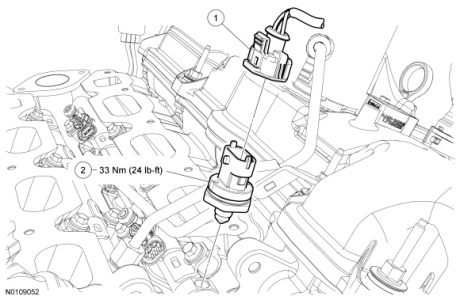

Hey everyone. Seems I can't win. I need to replace my fuel pressure sensor. Is there a trick to it or do I have to pull the intake? What a fantastic design decision. If I have to pull it are there any particulars I need to know like hidden bolts or things to watch for? And I'm gonna stop saying I love my car. Every time I do I get a light on the dash. lol

Fuel Rail Pressure (FRP) Sensor​
1706618079573
Item Part Number Description
1 14A464 Fuel Rail Pressure (FRP) sensor electrical connector
2 9G756 FRP sensor
Removal and Installation
WARNING: Do not smoke, carry lighted tobacco or have an open flame of any type when working on or near any fuel-related component. Highly flammable mixtures are always present and may be ignited. Failure to follow these instructions may result in serious personal injury.
WARNING: Before working on or disconnecting any of the fuel tubes or fuel system components, relieve the fuel system pressure to prevent accidental spraying of fuel. Fuel in the fuel system remains under high pressure, even when the engine is not running. Failure to follow this instruction may result in serious personal injury.
  1. Release the fuel system pressure. For additional information, refer to Section 310-00 .
  1. Disconnect the battery ground cable. For additional information, refer to Section 414-01 .
  1. Remove the intake manifold. For additional information, refer to Section 303-01B .
  1. Disconnect the Fuel Rail Pressure (FRP) sensor electrical connector.
  1. Remove the FRP sensor.
    • To install, tighten to 33 Nm (24 lb-ft).
  1. To install, reverse the removal procedure.

2010 Taurus Workshop Manual
ItemPart NumberDescription
114A464Fuel Rail Pressure (FRP) sensor electrical connector
29G756FRP sensor
