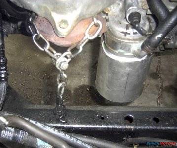

Put a chain on it around the front exhaust manifold to the subframe. Had one for years and never had to replace any motor mounts.

What's horrible about it? Genuine S. African ss chain it is along with 316 ss bolts.......
Plus it has about a 1/4 -3/8" play so it does allow some movement.

You aren't thinking. How can a chain with no tension on it transmit vibration. That's the main advantage over a solid mount.
And what's the risk?

Transmitting vibration the same way per say a y-pipe would do if it was rubbing against the subframe or tranny pan for some reason. There is only one advantage of a chain over a solid mount...it's a money saver.

Saving money is something to look down upon? It does not transmit vibration unless you are under power and have tension on it. Then you don't care. But when cruising or idling then no vibration.
Go over on the Gen 2 forums and say what you want.
The V8 is perfectly suited for this as there is a hole already in the subframe directly under the manifold. Not the case with the other SHOs.
