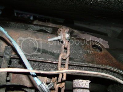

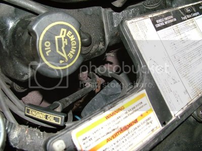

I made up a rear mount filled with urethane. But the only mount I ever broke was the tranny side mount. If you have a chain the rear mount never gets stressed.
But I am talking about the Gen 3 V8. Not a V6 SHO or any SLO.

Do you really have a problem with too-high torque in reverse? Are you flooring it backing out of your driveway or something? If it's really an issue, you can chain down the rear exhaust manifold too.
A solid mount is solid under compression, extension and stasis. This means that it transmits vibration 100% of the time, and it keeps the engine from moving both forward and rearward.
A chain is solid under extension only, not compression, and if left a hair loose, not under stasis either. This means that it only transmits vibration only when under extension (i.e. accelerating enough to take up the slack in the chain). It only restricts rearward engine movement.
They solve two different problems, and IMO there is elegance in simplicity. If you knew Paul (SHOZ123), you'd know that just about everything he does is well thought-out and engineered, and I'm confident that he went with the chain design because it made the most sense for what he wanted to accomplish.
I don't think it's ghetto or "rigged" at all. It's simple, but well-designed, and IMO the best solutions fit that description to a T.
YMMV.

Something just occurred to me... You guys realize that Paul isn't suggesting that anyone replace the front mount with a chain, right? It's a supplemental addition.
I'm still struggling to figure out how "if your rear mount lets go completely you're screwed" any more with a chain than without a chain, and that was the only thing I could think of.
