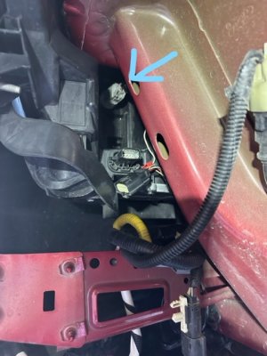

Finally got around to replacing the front side marker light bulbs today. Had replacements hanging in the garage for, oh, maybe 2 years! I knew it would be a royal PITA and it was. Decided to completely remove the inner fender liners so I could get my arm where it needed to go. I don't have large hands but could not get them either released or reinstalled without some long reach needle nose pliers. I put a bit of dielectric grease on the bulb socket seals before reinstalling them to reduce the friction and that helped. Good luck to anybody doing this.
Pic below of the connector before removal.

They really are the biggest pain to change on this platform, I used a long skinny flathead and stuck it in the socket, turned to unlock and pulled socket back to me.

I feel your pain. I just couldn't get where I needed to be to get to them by pulling the liners back with the wheels on.

Try the long skinny flathead method, mine is about an foot long, small tip, all I had to do was remove liner, stick flathead in socket and there was enough wiring to pull it close to me to change bulb, but yeah dang, there is just some engineers out there with no common sense on their creations.
