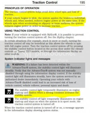

Auggie, I wouldn't call it loud banging at all. I would describe the normal operation of traction control as somewhat of a grinding sound along with power loss. It is applying brake to the spinning wheel and cutting power. If you are getting a loud banging, you might have an issue.... Here is what the manual says and I highlighted a couple of things:
Traction20control zpse1r6ymdh
