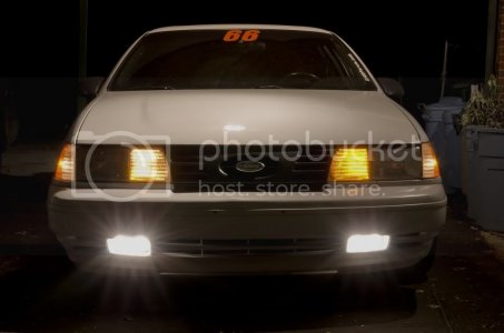

Hey guys I've been having problems with my fog/driving lights on my 91 SHO. I've since replaced the switch and lights. I even have completely rebuilt the original housings since the ones on the car were broken and rusted away. But they still do not come on! Any help would be greatly appreciated.
