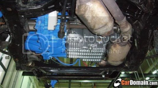

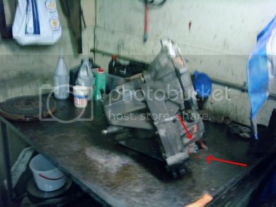

You have this,
110808 225300 1
You need this,
Enginelowerrear

Thanks for the link Vortec! Definitely something I may have to go with.
Did you buy one/install one? Just looking for someone with personal experience.
