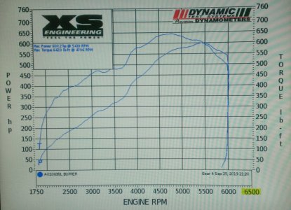

The motor is STOCK internals.
The car has the following mods:
Dual in tank fuel pumps
6 auxiliary injectors
Split-Sec aux injector controller
Car runs on straight E85 - 23 degrees of timing.
PPE Engineering 2.5" catted downpipes with stock cat-back and sound performance racing cutout.
Custom turbo to intercooler and intercooler to throttle body piping with silicone tubes to replace factory plastic/rubber parts. Replaced factory electric BoV with Tial BoV.
First night
First pull 505HP/515TQ 15PSI - using stock ECU for boost control
Second pull 563HP/598TQ 23PSI - removed connection to factory boost controller, turbos running on wastegate spring
Next night
Third pull 587HP/642TQ 25PSI - same as second pull - allowed the boost activated cutout to open
Fourth pull 592HP/630TQ 25PSI - same as third pull - disconnected piping to filter in the fender
Fifth pull - not on video 600HP/642TQ - Cutout open, car had sat as we were uploading files to ECU - car was running cold air intake
We haven't tuned the car yet, this is a tune from Torrie at Unleashed from months ago on my old compressor wheel upgraded turbos with E85. We're just adding fuel via aux controller.

That's wheel HP! Holy mother! :eek: That's like 750 crank hp!!
Is your drivetrain all stock too?

No mods to drivetrain that I have seen. Has been a challenge to control timing of the power transfer between front and rear wheels. Would like to go RWD at launch, basically, but PTU design may limit that to 50/50.

No, not possible right now and even with a new HPFP and injectors they won't support the power levels where I'm going :)
Next mod water to air intercooler, then some ported/polished heads and forged block. :)
