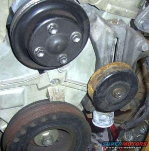

Looks like my alt/ac belt idler/tensioner needs replaced. I've read that I can either use the bearings from a V8 SHO pulley or just use the whole pulley itself. Has anyone actually done either of these and driven the car afterwards?

The F6DZ-8678-A that came was something totally different than what I expected, a tensioner of some kind, about 1.5" in diameter.
Then she came out with a pulley very similar to the one in the pic above with a different PN that at the time I thought I could make work. After bringing it home I realized I don't think I can.

The problem is you are getting the GEN 3 tensioner pulley. You want the Gen 3 idler pulley. The idler pulley has the exact same bearing that the Gen 1 and 2 tensioner pulleys have.
Yes that idler pulley is off of my '97 ve8 motor. They have three of them. The '99 pulleys are a bit different as they have a lip on the back edge but they are interchangeable.
I will send you a picture of the two different types. Tomorrow I will look at the actual pulley but I don't think it has any numbers on it other than the actual bearing NSK part number.
