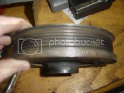

Got to spend more time on it today.
taking the pulley off the spare engine I managed to do this
SHO019
hurray for lifetime warranty on craftsman tools :)
well the pulley was a bit rusty, but nothing a wire brush wheel can't fix :)

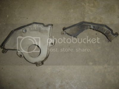

Well we called it a day after we couldn't get the middle belt cover off.
We're going to attempt that tomorrow...anyone have any suggestions on how to take middle belt cover off. Our plan of action is to get the belt off, replace the belt and the sensor, and put it back together and see what happens. btw. shophoenixproject is a wonderful place.

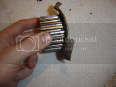

AAHHH so close. we got the cover off today, and look what I found!!!
SHO033
ah ha ha... heres part of the sensor.
SHO032
mmm broken sensor.
SHO031
so i had that extra sensor, but that wire was sticking out of it, so I'm going to order a new one. we tryed it anyway, and put everything together (new belt too) and it almost turned over, but didn't, and after a check, there was no spark still. so off to Rock Auto I go. So I felt like we were so close, and it just knocked me down haha.. Hopefully with a new sensor, it'll work :biggrin:
