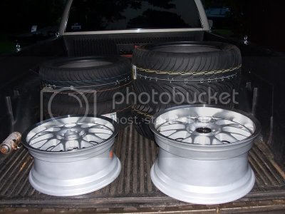

p 205 50 16 front
p 245 40 17 rear
I may be going to a p205 40 16 up front to gain a little more clearance and drop it a little more.

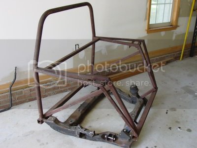

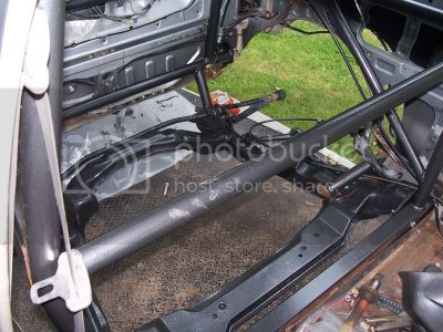

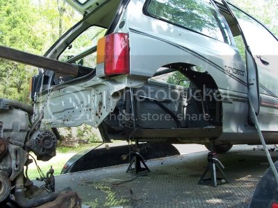

Heres how the sub frame worked out. The front subframe mount "eyes" were cut off and flat plates were welded on. These each have a bolt hole on each side that attaches to a 2x3 cross memeber welded into the car.
The rear is close to the same, a couple plates welded over the rear subframe mount eyes, these bolt to the roll cage. I mounted mine a little higher up into the car to make it sit lower then a factory shogun.
100 0931
to pull the engine / subframe you lower it to the ground, unbolt the 8 bolts, put the engine hoist inot the rear hatch , attach it to the roll cage and lift the car. Then just slide the guts out the back.
100 0923
Heres a REAL RARE PICTURE !!
This is the last surviving SHOgun subframe that was never completed, along it life the subframe was switched from a MTX unit to a 3.8, the roll bar, strut support and cross memebrs are correct for a Shogun. You can see how it was all welded in place.
