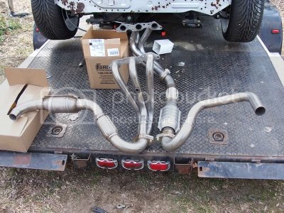

1 5/8 stainless long tube headers, dual cats / mufflers

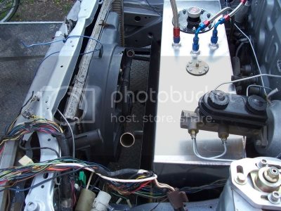

complete inner engine compartment out of aluminum and carbon fiber lined with a sound deading material, It will be carpeted over. fiberglass inner wheel tubs to keep out the dirt

any more pics???? stainless headers and exhaust.
