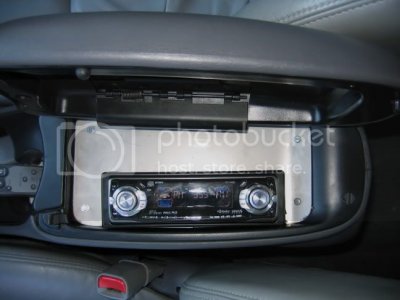

Update
Bringing this one back from a couple months ago. Here is what my radio looks like now, all installed and working just fine. I've had it like this for about 8 months now.
NikonPhotos003
Possibly this Christmas break I will look into making new cables so that little pile of electronics can be remotely mounted, far far away. Anyways thought I'd share. I know JSIL1, and Shogun_it have also done this. How many others are out there?
Sure it doesn't look exactly perfect, but alot of people think it's cool that it's been fabbed into the ashtray.

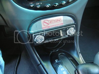

I've got that setup in my 97. To my knowledge I was the first person to ever do it. I bought my SHO and within a week or so had my CD player and crossover mounted in my arm rest, then decided that I didn't like that. so a few weeks later while I was in calculus class thinking about my SHO instead of paying attention a crazy idea came to me, I don't remember there being anything behind where that ash tray is. so as soon as I got home I took the car apart again just to see if there was any possible way it would work, it looked promising, so I went for it. turned out great. I posted my results to the V8 e-mail list. it seems that it was a while before I ever heard of anyone else who had tried it and since then I've seen several other installs. I put my CD player up higher and had to cut into the radio bezel some (every once in a while I regret doing that, but I bought a backup piece) and mounted my crossover below it. then a while later I came back in and put a switch panel below that which has controls for my cutout, lights, bass boost on the sub amp and stuff like that.
It actually looks better now than it did then, this was right after the project was done, since then I've cleaned it up a bit and put the metal label plate around the bass boost ****.
