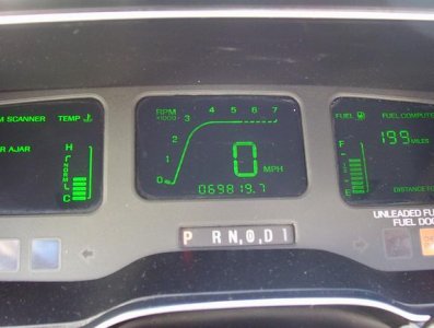

I call 2nd gen lighting "blue" even though it's closer to teal. The 1st gen green is very green. Here are some good pics to tell the difference:
Green20digital20cluster
^green^
^blue^
It'***** or miss on what cars had what colors, though most cars from the early to mid 90s all used blue. I know the 93 and older mustangs are green and the later Contours are green. If the seller cannot tell you I usually try to find a car like it came out of for sale on ebay and see if there is a shot of it with the display on. Most of the blue ones I have found have had the clock but that won't matter if you just swapping over parts to a non clock one. Changing one over is easy: pop the face off (2 screws at the most) and then take the board off the pace (5 or so screws), be carful to not knock the buttons out. The button color is done with a big colored overlay and the display lense will just pop out. The one I have plays CDRs just fine.

Okay... it makes sense with the pics up there. Thanks! I really would like the display to be blue to match. I think I may have a difficult time finding blue though. The units on ebay are usually not lit. I did find an Aspire unit that looks identical to the one pictured above. Did they really use these units in an Aspire???
