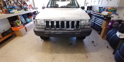

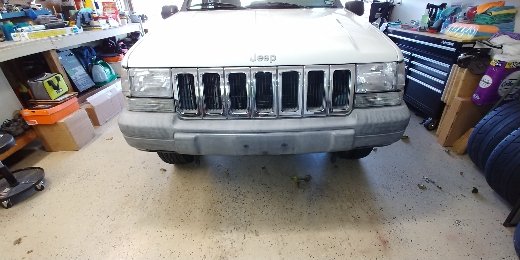

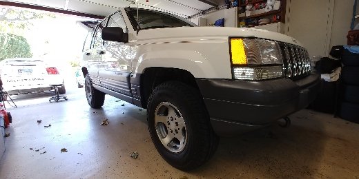

Here's some. Stuff is pretty shiny too. B76311d91f31912fd9b0a5515e0b4ca3D95f7487a32c65e5d289ea82e8534ec8D999aeb7b038b9929f8f1f08e7587382
