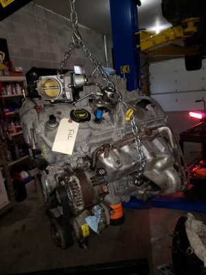

Getting ready to install the replacement engine.1ecefb67848959cd675e1f10ee4e5ef6F3dbadd331ce3ce3bf9b0878ab546fb4

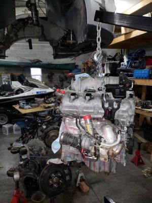

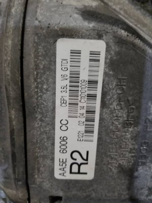

Hi folks, my replacement engine showed up and it looks like it's a 2014 if I'm correct by the sticker. My car is a 2011. Can anyone tell me if this will work or if I'll have to change a bunch of the sensor's.B6ce6a7acda93414ea9bfcfd08267ce5

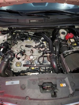

Replacement complete, runs great. In the lessons learned category I would recommend all new turbo seals for oil and coolant lines. I had the rear leaking and it was tough to replace in car. I will also drop the entire strut next time and put the subframe on jack stands with wheel dolly's. Was tough getting it aligned when lowering the car .
All in all these cars are pretty easy to work on. For my next one I think I will rebuild the engine instead of a used engine.Fa5e6337ca614b4f8727f2c62fe14731

Its always a PITA working within the confines of the engine bay on FWD cars lol. I remember when I saw the SHO 3.2 on a stand, thinking how small it actually was compared to the fear factor of working on it.

I spoke too soon, I have a coolant leak under the Intake. I didnt replace the crossover tube oring after I moved it around some and its leaking. I also reused the intake o rings and I suppose the rear coolant passage could also be the cause. Bb378c0cd44b157a0235e53d166c9770
