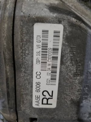

Hi folks, my replacement engine showed up and it looks like it's a 2014 if I'm correct by the sticker. My car is a 2011. Can anyone tell me if this will work or if I'll have to change a bunch of the sensor's.B6ce6a7acda93414ea9bfcfd08267ce5

you will have to SWAP over a bunch of the 2011 sensors to the 2014, and the crankshaft tone ring as well. there are threads detailing the projects also.
This is my first EcoBoost project. Can you tell me where this time ring is located? Does the timing chain cover need to be removed?

13,265
It's on the crankshaft for the crank sensor to read as it spins. If you remove the crankshaft pulley/ harmonic balancer you will see it. One model has more teeth than the other & won't read properly.
There is a thread on here with side by side pics I think

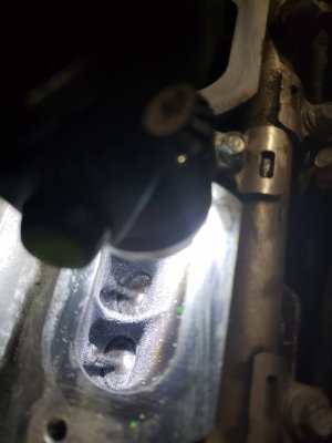

The engine is out of the car. I have a lift in my garage so that was pretty easy to drop. I see the crank sensor on the rear if the engine and the pulse wheel behind it now. I pulled the intake and all valves are covered in gunk and oil crud. Looks like the failed turbos sent a lot of oil downstream. Looks like I'll have to pull both heads and clean them up. Not sure if the crud accounts for the low compression on 2 cylinders however. I may have 2 problems.Ee90ab8e414ef40f2d20b5d856fde085

13,265
Yuk. Well is your replacement engine new or used? I assume you have to send the original as a core if replacement is new or reman?
Sent from my SM-G965U using Tapatalk
The compression leak is coming from the valve. In the video I have my leak down tester at 50 psi and the air is pouring around the valve. I added oil to show bubbles. 65bd66a4e9fdea2c555c84746d2b839f
No core charge. I was hoping to have an easy fix on the current engine but no luck. I pulled the head and 2 cylinders (5 and 6) are scored. So it would need piston and rings assuming the scoring could be honed out.
