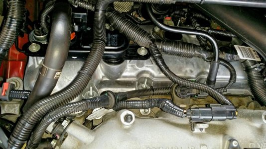

U can check the PCV valve/oil separator fairly easily. They are located on the bank 1 valve cover, near the firewall on the pass side of the engine. Cleaning them is not really effective, and the part design has been updated since it was originally installed on your SHO.

Cleaning is not very effective, best to replace with the newest design.

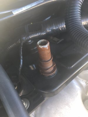

Checked the throttle body pipe and cac today. Dipstick pic is how much was in there. I lifted the drivers side up so it would pool better. I used a hand pump and didn't get much. Tempted to use my electric pump but I don't want to catch my car on fire if there's fuel in there.
Tubing pic is yellow with residue, all gunked up. Kinda worrying. My finger pic is what I wiped out of tube.
I also found some oily dust on bottom of noise maker that was caked on there.

Def got enough buildup, but now that you have cleaned out the cac, you can monitor the actual rate under YOUR driving conditions. The crapola was definitely getting pulled into the CAC-throttle body pipe. The dust on the NM doesn't look too bad, I would, again, clean and monitor rate of buildup; also consider eliminating the NM altogether, either with a cap or a part from a police interceptor, MKS, etc. Expensive parts but cleaner look and also elimination of a possible boost leak source.
Looks like BOV replacement time.
Did you check the throttle body itself? Does it look clean front/back? Also check the TPS connections, make sure they are free of dirt/corrosion, add some dielectric grease to keep them that way.
