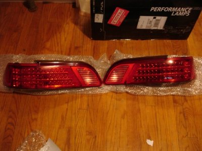

I believe I'm the first to get them on. :evilgrin: Any who... they will need the grote flasher to work correctly. It is only with the lights on and the brake applied that you get the fast signal flash. Lights on or off with no brake and the signal works fine. Lights off with brake and the signal also works fine. The wiring all plugs in perfectly, using the original plugs, they then go into the housings like normal. Perfect plug and play just needs the grote flasher. My only disappointment is with the design of the reflector. There's simply barely any reflector material on these lenses. I do like the clear lens though. Videos are on the bottom.
Dsc10095
reflector
Dsc10093
Very good fit

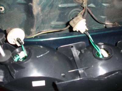

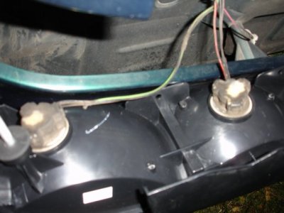

Wiring, straight forward, make sure the connector is the correct direction, they only plug in one way.

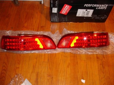

Parking lights. Don't seem to be very wide angle LEDs, I'm sure it won't be a problem at all for anyone behind you. But it's the details.
