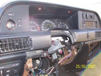

Thank you both for the advice and the photo. So it looks like the steering column has to come out to get the instrument panel pieces
off. That's more than I was expecting. But I will give it a try as soon as I can set aside the time.
Richard
This picture is part of the preparation to remove the dash. You don't need to remove the steering. You just need to remove the under-dash panel. I don't expect you'll need to un-bolt the headlight switch either if you have enough extra wire behind to pull it out and unplug it. After the bolts are out, then you just need to pull on the bezel slowly but firmly to disengage the push clips and unplug the rest.
