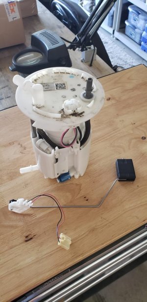

Stock LPFP hanger assembly:
IUkEbwJjQuOaM6width498height1024cropmodenone

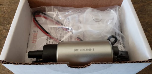

DW300c in the box:
IcMpCPGDfhI26hwidth1024height498cropmodenone

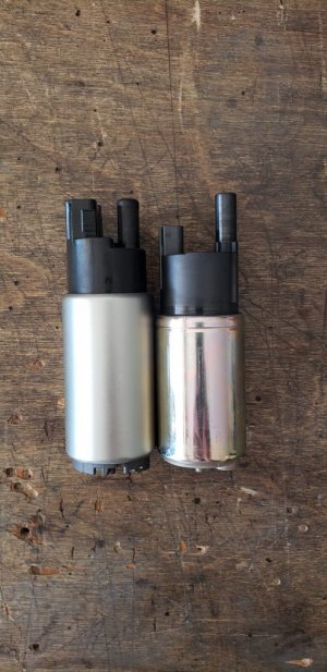

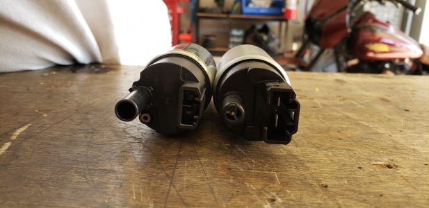

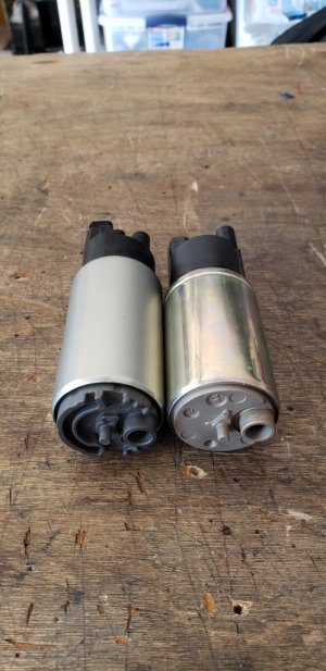

Some comparison photos between stock pump and DW300c:
24uF0CIclNzR3jwidth498height1024cropmodenone
KVfL8uBu3f4j Owidth498height1024cropmodenone
F85A0obqotraeqwidth1024height498cropmodenone

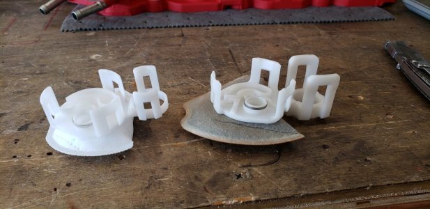

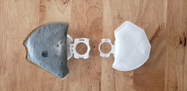

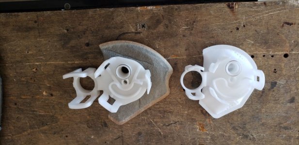

Comparison photos of the stock filter sock vs. what comes with the DW300c. In the video, I show how you will have to slightly modify this part to make it fit right.
CraPV7ER875UIjwidth1024height498cropmodenone
De8vcbwm2O Sevwidth1024height498cropmodenone
ZGIgETPaNyp0FBwidth1024height498cropmodenone
F 3ho1qVjyyyRnwidth498height1024cropmodenone

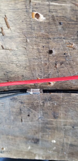

A few more close ups of the wire connector (Toyota PN: 90980-11080) I modified in the install video.
SHs do5l6Bu8ljwidth498height1024cropmodenone
Links to the pins/splices you'll need:
KXyfJofSikZM6Gwidth498height1024cropmodenone
RvsNCUBFZyHhejwidth498height1024cropmodenone

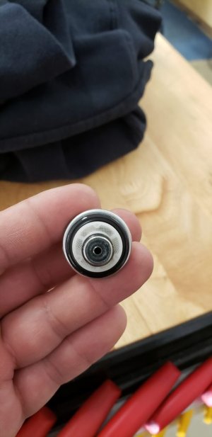

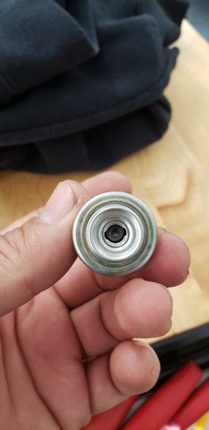

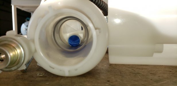

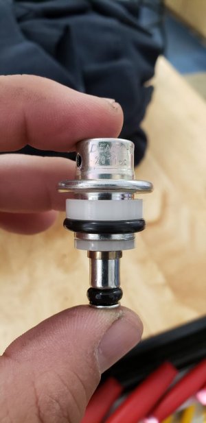

Here's some extra pics if anybody wants to know details on the fuel pressure relief valve that is inside the hanger.
AxSgB7IakH1eyOwidth498height1024cropmodenone
MWN8iv0v3UoynGwidth498height1024cropmodenone
NbhPvtow6hRfXAwidth498height1024cropmodenone
UYjNI0EvT2e6CWwidth498height1024cropmodenone
