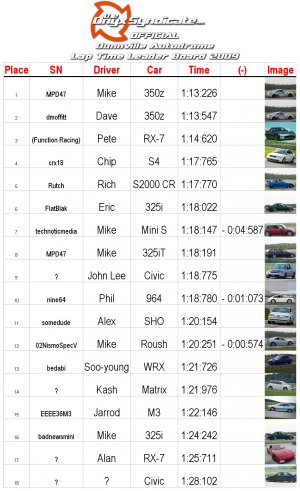

at the end of the day I ran a 1.2X when we did the timed event. Which is not bad for street tires but I could have ran a **** of a lot better had I bolted my R comps on. nearly everyone else that ran the timed event was on race tires. fastest car of the day ran a 1.13 but it is not street legal.
