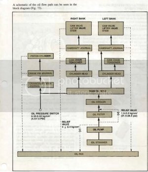

Picked up a dry sump from ebay so I've been doing a lot of research on installing one.
Oilflow
This is the oil flow for the SHO. I would gut the stock oil pump (remove one/both halves of the gerotor), does anybody know if this will cause a problem? Do I need oil through the pump to lubricate the front main bearing or anything? I don't see a problem in my head but I don't have an engine handy to look at right now.
Secondly, it seems like I could get a remote oil filter adapter (example) and cap off the inlet, and just run the pressure side of the pump into the outlet. This would leave the passageway from the pump to the filter through the block dry. This would also bypass both relief valves, how do I make sure the pressure doesn't get too high? Do I even need to bother with relief valves with the dry sump or are they just to protect the stock oil filter?
FYI more relevant diagrams and info are on page 65,66,67 of the SHO engine book (Which is page 35,36,37 of the pdf, I don't know why it's missing 30 pages).

I think you can safely remove both pieces of the geroter from the oil pump, the forward main bearing is oiled from the main oil galley that is drilled through the block on top of the crankshaft. The front main crank seal needs a bit of splash lubrication, but it should be fine.
I think your best bet would be to pressure feed the block at the center of the oil filter boss, you're not going to have a filter at this location anymore, as you'll be doing your filtering in-line, probably after the pressure stage and remote pressure relief valve. Additionally, feeding oil in at this location bypasses the oil pump relief valve. The other relief valve shown in your diagram is the pressure bypass that's built into the oil filter.
