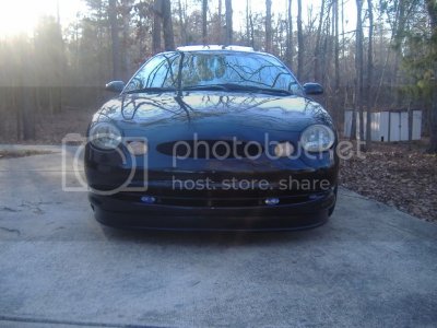

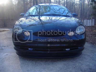

I installed some PIAA lights a few years ago, I put mine in the lower portion of the air dam.
DSCF4303
DSCF4298

Very easy to install. Remove the plastic splash guard from under the front of the car so that you can access the inside of the air dam. I didn't want to use the switch that came with the lights so I removed the driver's side headlight and connected my lights to a parking lamp wire, (I think it was tan, not sure, perhaps someone could verify), as I wanted the foglights to turn on when I turned my lights on.
I have thought about relocating the lights to the upper vane of the air dam and out to the edges. I chose the PIAA's for their size, and the fact that they are oval, I thought they went with the design of the car.
Silvapain's set up does look good. There was a thread on here recently about Gen 3's and slicer wheels that shows his car and you can see the lights.
