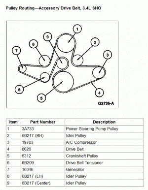

You need a 3/8" long extension and a 3/8" breaker bar, or at least something like that.
To remove, jack and support the passenger side. To make things easier remove the wheel. Stick the 3/8" extension into the square hole on the tensioner (just forward from the alternator) and push towards the rear (I think). Once it is up take the belt off, then release the tensioner.
Putting it back on is a bit tricky, I loop it all around then leave the alternator for last when you again have the tensioner pushed up.
Drive belt routing v8

It's not a very hard job if you ask me. And I turn every job into a hard job. As long as you have the right size belt and a helper it's like a 10 minute job even for a guy like me.
Silvapain
Feb 7, 2005
865
69
Limestone, IL
Four drive pulleys, three idler pulleys, and one tensioner.
You may have to use a long screwdriver or a straightened out coathanger to get the belt around the #9 idler pulley, but other than that it's pretty easy. However, I put a gator-back belt on recently and I found out that they are just slightly shorter than standard belts on the V8, and it can be hard to get the new belt around the tensioner.
