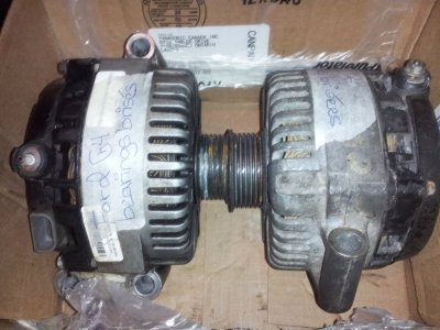

You could have a bad pulley on one of your accessories. I remember that there are 2 different pulleys for the alternator. One is a little bit larger. Sadly, when they are replaced, part number refer to the alternator, not his pulley. The SHO alternator was shared with the Windstar which have a bit larger pulley IIRC. It could be also the pulley of your new pump maybe (but I don't know variants for this pump).
