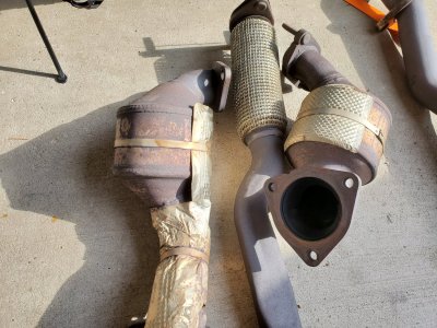

Which one should I install first, Downpipes or a Cat Back Exhaust?
Downpipe, seems Corsa catback will give you rasp with downpipes. My PPE catted will be here in 2 weeks. I already have MRT axle back with resonators due to drone issue. If I have rasp after downpipe install, I'll update and let you know mrt is as faulty for rasp with aftermarket downpipes. I've kept my stock mufflers in case of rasp issue, downpipes are for earlier spooling and torque staring at lower rpm. Best benefit.

Downpipes, I personally like the sound of downpipes with the stock catback. If you want more rumble add a Magnaflow resonated X-pipe in place of the stock crossover and resonators and it'll sound great without being ricey.

Downpipe and a 3rd cat delete otherwise you'll have horrid rasp, I replaced mine with a magnaflo xpipe/resonator and it sounds great.
