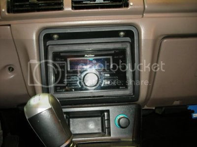

I just used the DD install kit available from best buy. They sell it for 40 bucks or so, but i got it for 2 bucks from a friend that works there. That was his employee cost.
The deck is a pioneer 8000bt
Pioneer001
Pioneer8000BT

Did you paint your vents black or were they black already? My interior is exactly the same as yours except my vents are cream color and yours looks 10 times better. And the stereo, I bought the same one and i'm wondering if the trim ring you have came with the kit you got at BB or is it the one that came with the deck? Because the one that came with my deck is very flimsy and I hope I dont need it after I find this kit (which is proving very difficult). I'm tired of having this kick-ass deck and it not being in my car simply because I cant find a kit that looks clean like yours does and I refuse to do a half-ass job. Thanks man.
