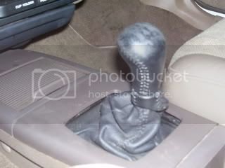

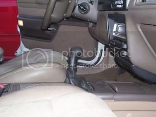

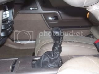

Hey guys. Check out what Tom and I created using the latest Dooleyville technology;) .
100 0150
100 0159
100 0157
100 0151

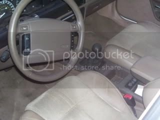

First three pics are in neutral and the last is 2nd... Bing!
We took about two inches out of the straight part of the rod and then reversed the foreward bend and tilted it back a bit. It's much more comfortable feels a lot more solid.
Total cost: FreeNinetyFree:p

That chopped shifter feels sooo much better than the stock one. I shifted it around for a little bit, and it doesn't have nearly as much slop as it did before. The throws are even a lot shorter and more direct. It's the first shifter I have actually been able to find 1-5 from the passanger seat on the first try lol.
Tom.. you should market these things... You could use that description I just gave as advertising. ;)

There's no reason that you couldn't do the same thing to a rod shifter.
FWIW, there's a difference between a "short-throw-shifter" and a shifter with a shortened lever. On one you move the fulcrum point further up, so that the connected part of the shift lever gets longer, and on the other you just whack off part of the top of the shift lever.
This is the second kind.
But that's certainly a do-able mod, and I think it's pretty cool how Nik's came out.
