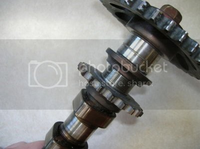

Do I need a weld?

You would be asking for trouble if you don't weld all four cams now. One thing you could do is pull the cams and send them to one of the best SHO cam welders. I think that a few of them offer this service. As far as pulling them and then re-timeing the engine, it can be done. But it will be a back breaker and a knuckle buster.
My 99 had the tick of death and I felt bad just starting it to put on the tow dolley. It had two bad cams and I welded all four.

Your bank 1 intake cam is already loose. My recommendation: don't start the car again until you get those cams welded.

Stop driving the car.
Get them welded, even if you have to send them somewhere to get welded.

Agreed- that one's a timebomb... Dolly it to a SHO cam welder and have it fixed before it blows that cam.

I never really thought about it.. but what in the world keeps the sprockets on the cam from the factory???
Silvapain
Feb 7, 2005
865
69
Limestone, IL
JB Weld.
Apparently, JB Weld isn't forever.
No, it's a mechanical bond. The cams are assembled in a jig, with the hollow cam tube small enough in diameter that all the lobes and gear easily fit over it. Then a hardened steel ball is pulled through the hollow cam tube, and it stretches the tube and presses it into the lobes and gears. The lobes and gears have small teeth manufactured into the inner diameter, and these teeth keep everything in place. This process is fine for the lobes, which have only to press on one valve spring; but it's not strong enough to handle the stresses in the secondary drive gears. The min drive gears are bolted onto the cams, so that's not an issue.

I would, (if your car was running correctly... not ticking, knocking, and your cams are still in the correct place) Clean the area around where the cams and sprockets come together (so you get a good clean weld), remove the spark plugs (so you can turn the crankshaft with a wrench) Them hire a master welder to come to you house (car) and weld them without removing them. That is what I did. Take proper precautions to make sure slag and debris do not fall down into the engine.
